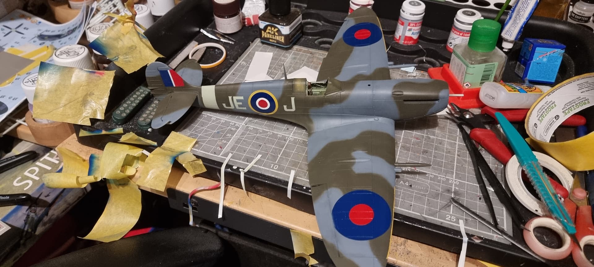

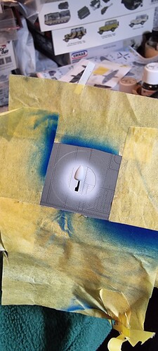

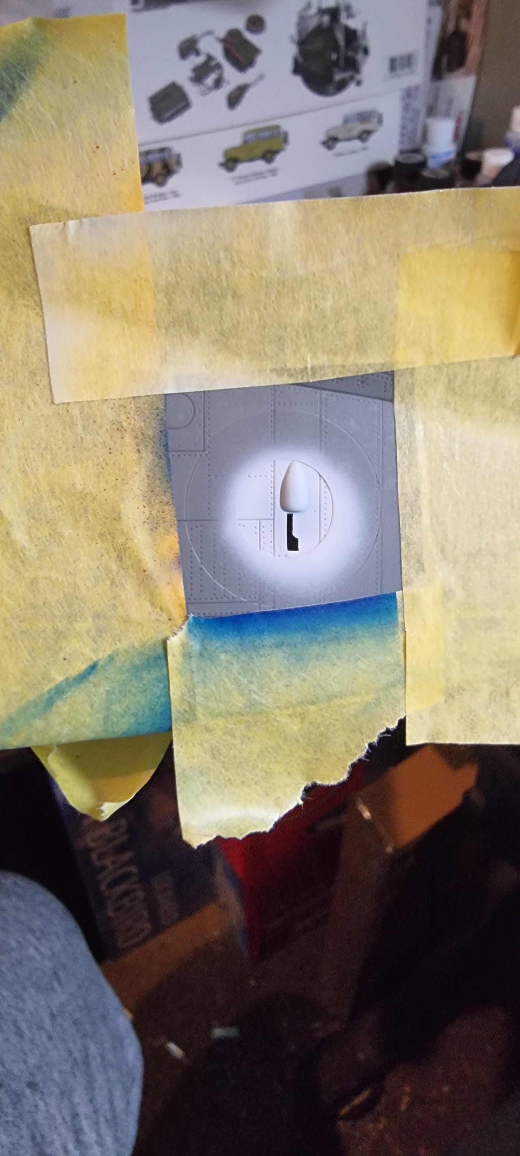

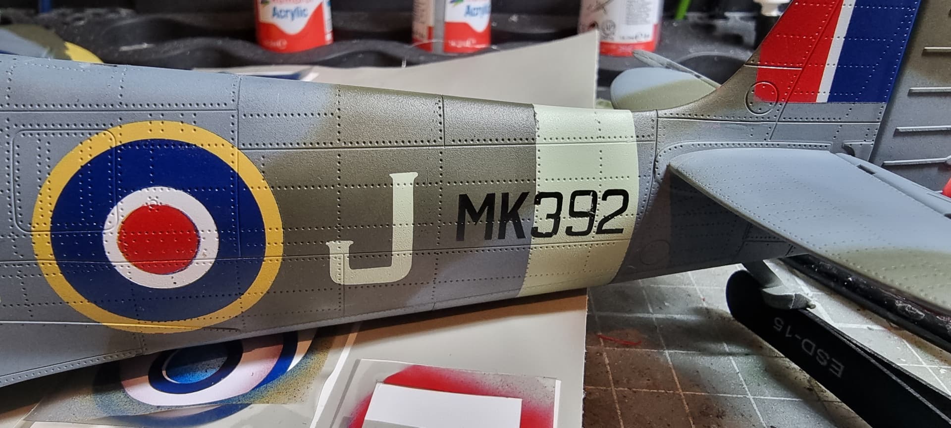

Here is some work i managed on mine on Sunday. These are all mask paint areas as I only use the stencil decals at the end.

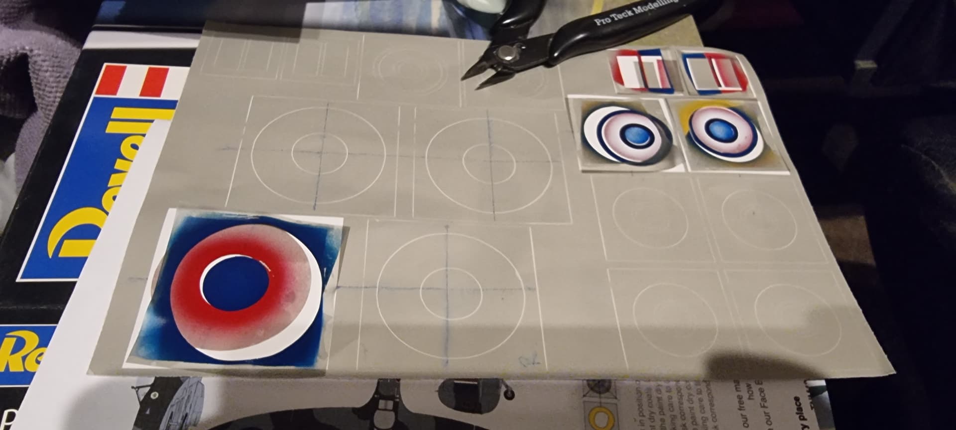

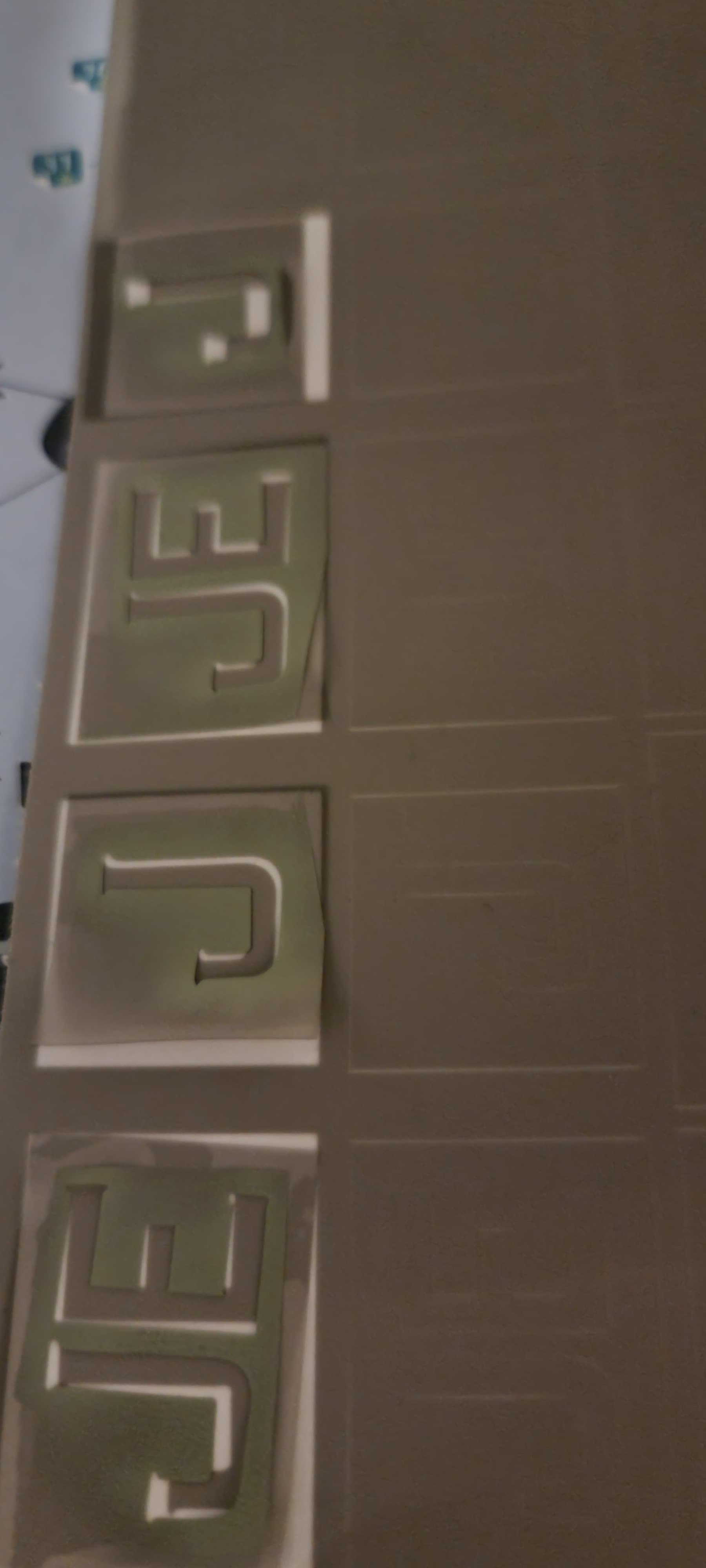

These are the masks…and if you are confident enough you can reuse. Notice I only used the one roundel for both wings…leaves me with spares.
Couldnt do the same with the letters as I sprayed that and the tail band all together.
Pete

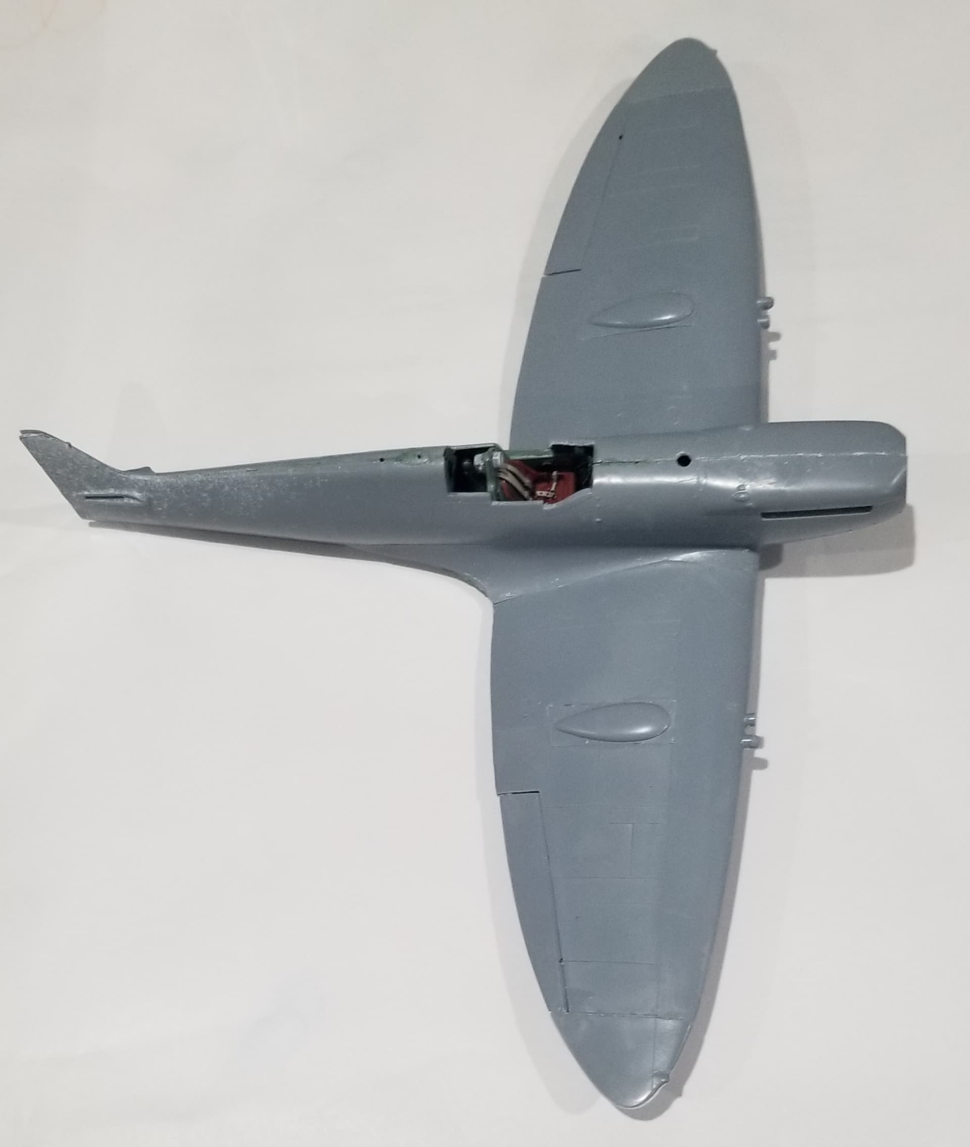

Got the cockpit in, it was a bit of fight to get everything staying in place putting the fuselage halves together.
Then i added the wings. The fight i had getting the upper and lower halves together was an indication of how this whole has gone together so far.
Lots of tape and clamps to try and hold the wings in place while the glue dried, still left me with some gaps and I’ll still need a clamp to hold the right side upper surface level with the fuselage.
What i should have done is thin the wheel well pieces to reduce how much flexing was required to get the wing halves joined, then everything else may have lined up better.
Damn, that is a sweet paint job!
Looking good tho Iain.
Thanks Erik the masks make a huge difference. Look so much more realistic and easy to use. You just have to line them up correctly at each spray stage. Plus you dont need gallons of micro set and sol lol
Pete
they look great!! where did you get them?
Joe
Got these off ebay. But its the same company i have bought from at shows.
This is their name and website.
Pete

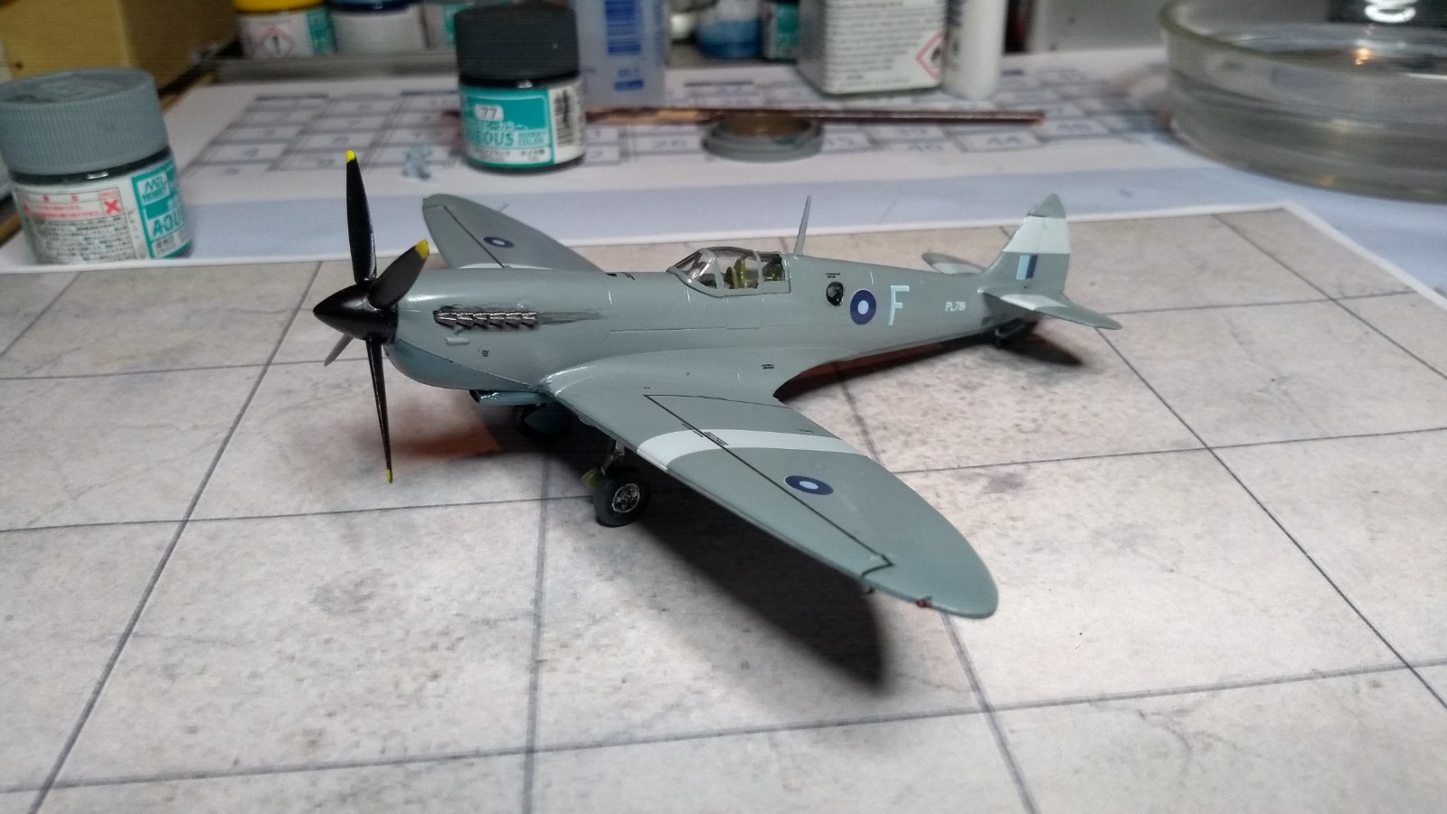

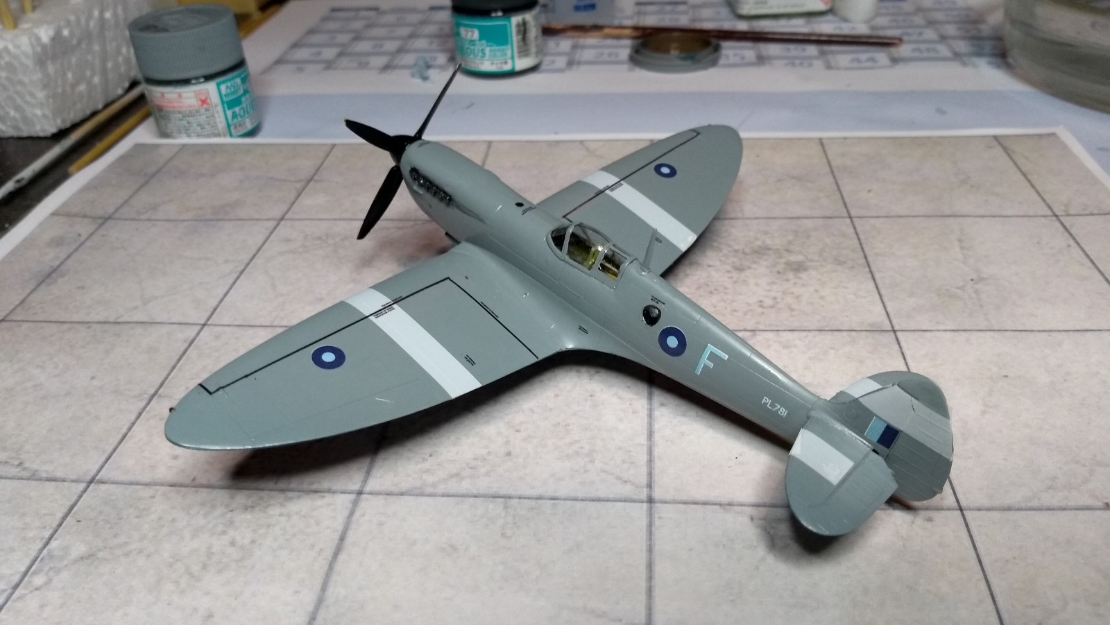

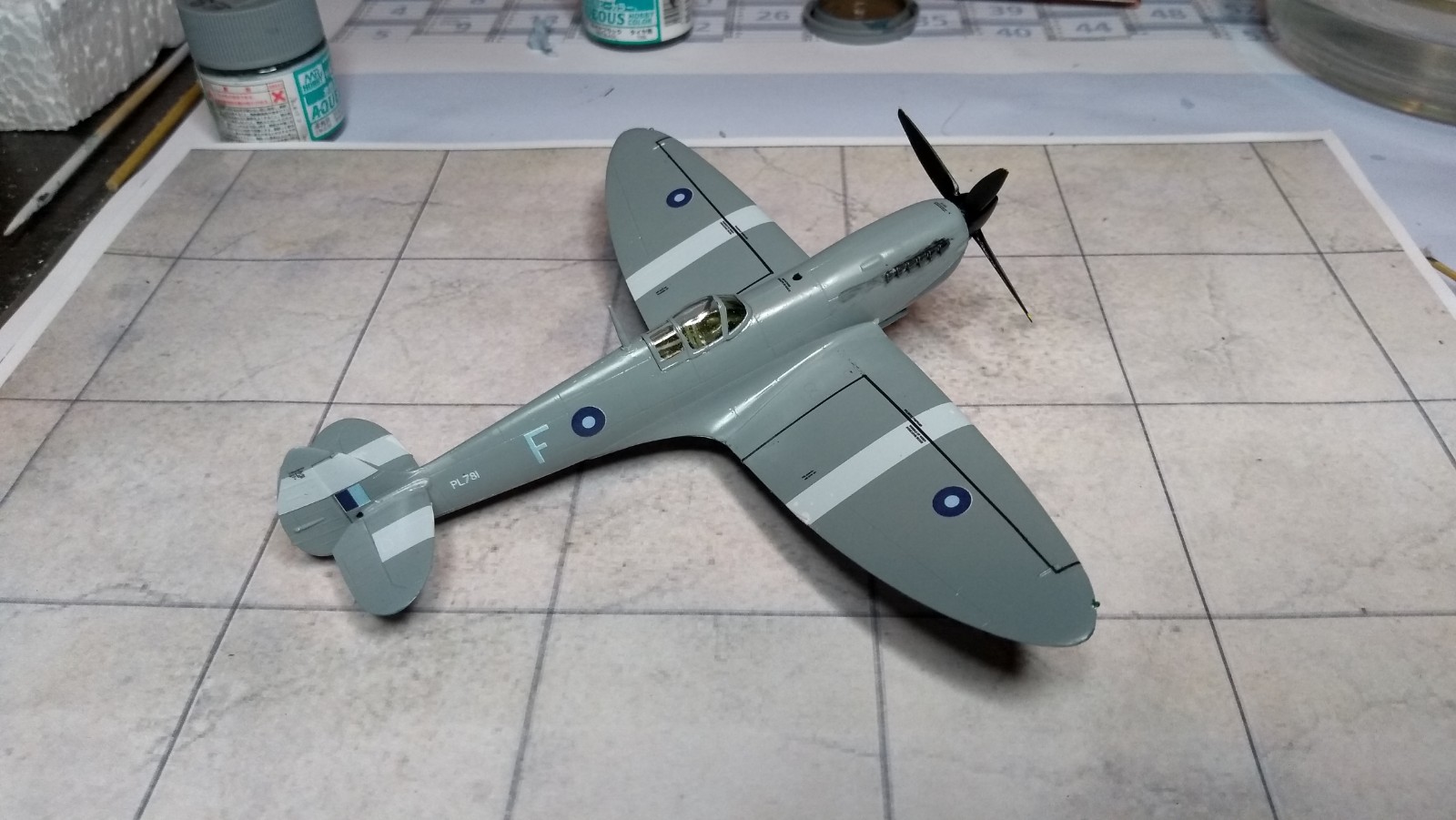

Calling my Spit nearly done! Better photos will still follow.
Good luck for your nice builds, mates!
Peter
…“business” as usual… ![]()
Nice looking seafire there Peter

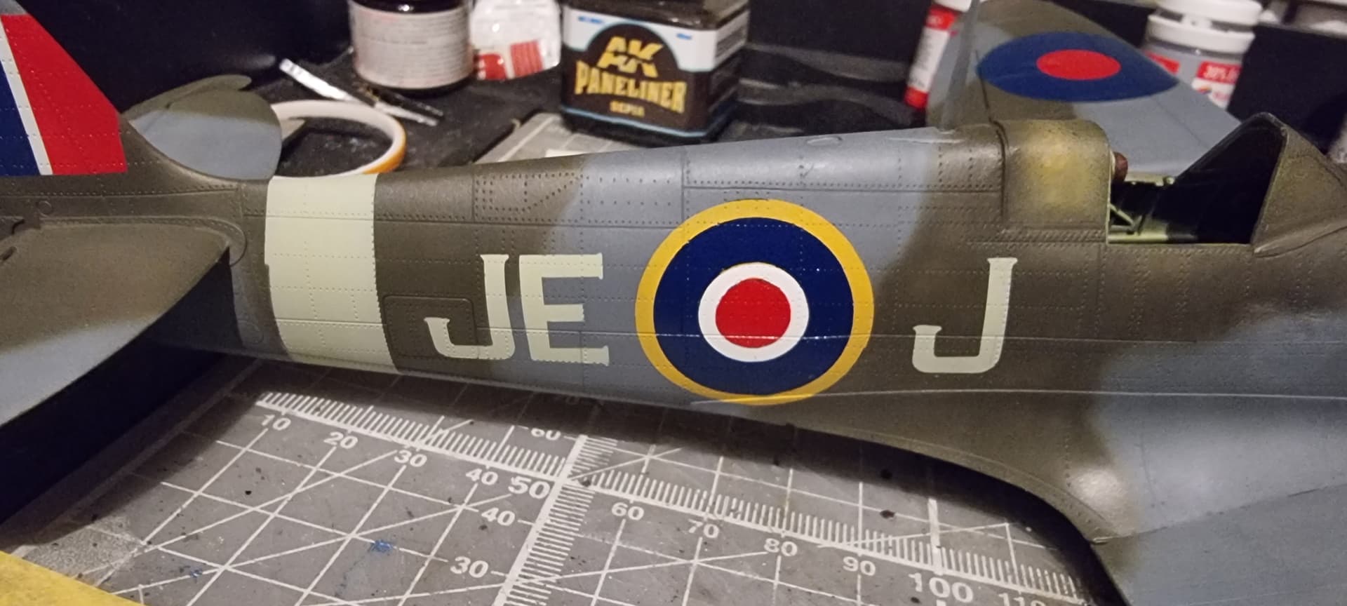

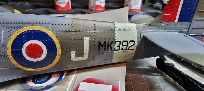

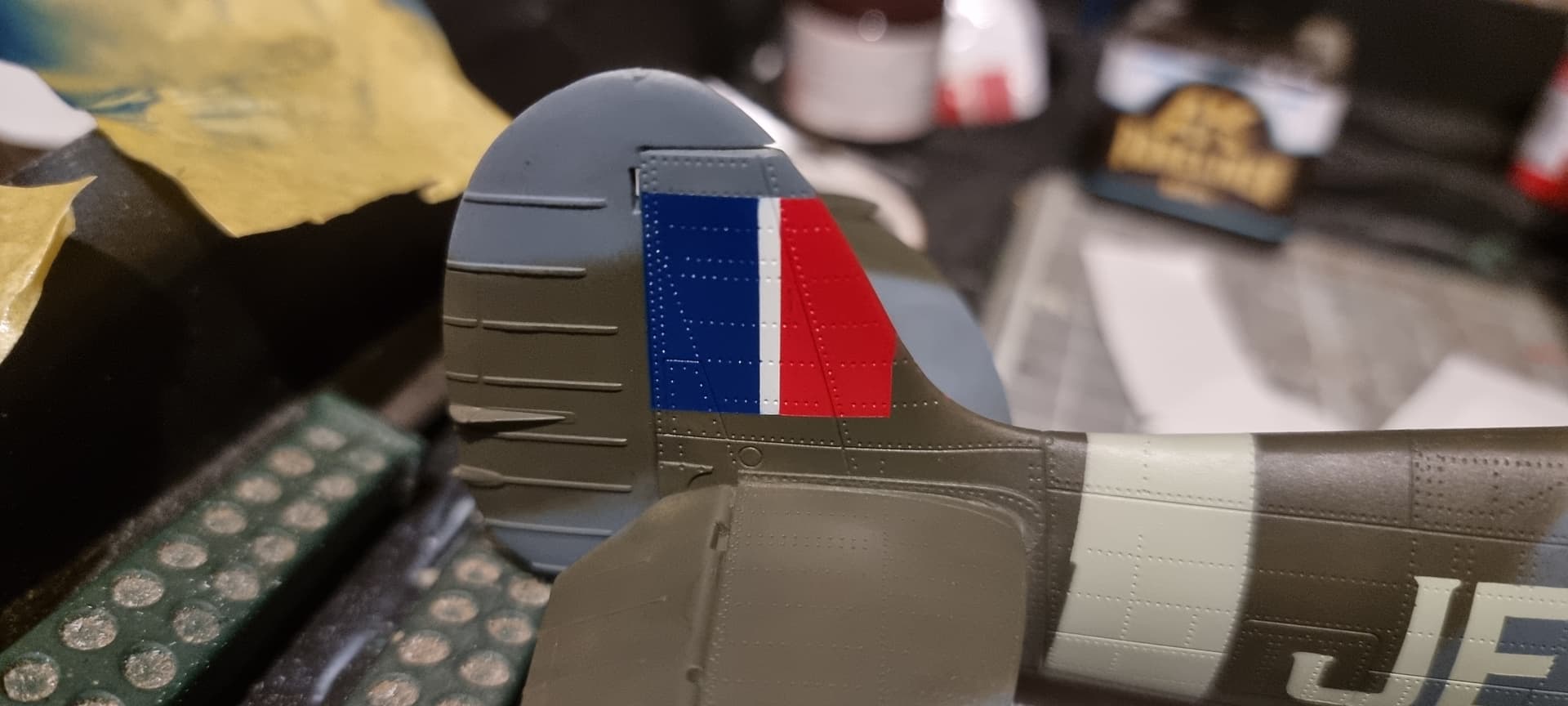

Aircraft lettering done
And i have started the roundels on the lower wing areas
Need to wait till tomorrow for the white to dry before doing the red and blue.

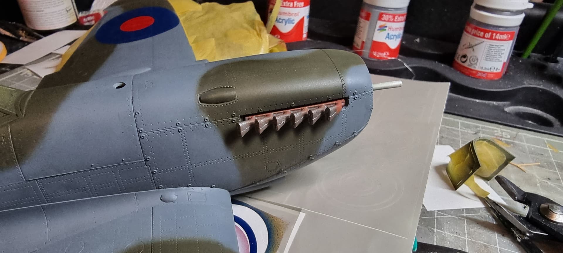

Did get the exhausts fitted
Pete

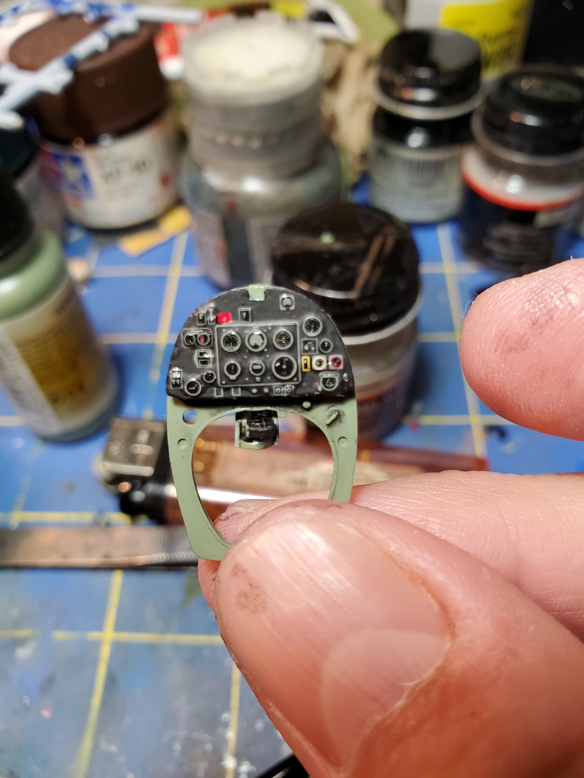

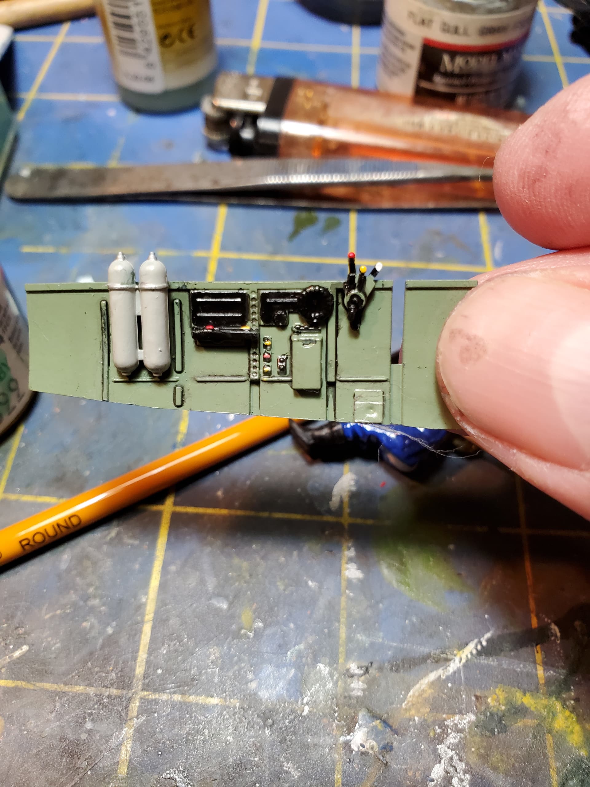

slow progress on my Eduard IXC spit. as great as they say this kit is i am not that impressed. i don’t like the way the cockpit goes together. the rear armor plate does not line up with the fuselage and test fitting the fuselage halves is difficult, practically non existent guide pins don’t allow the halves to stay aligned.

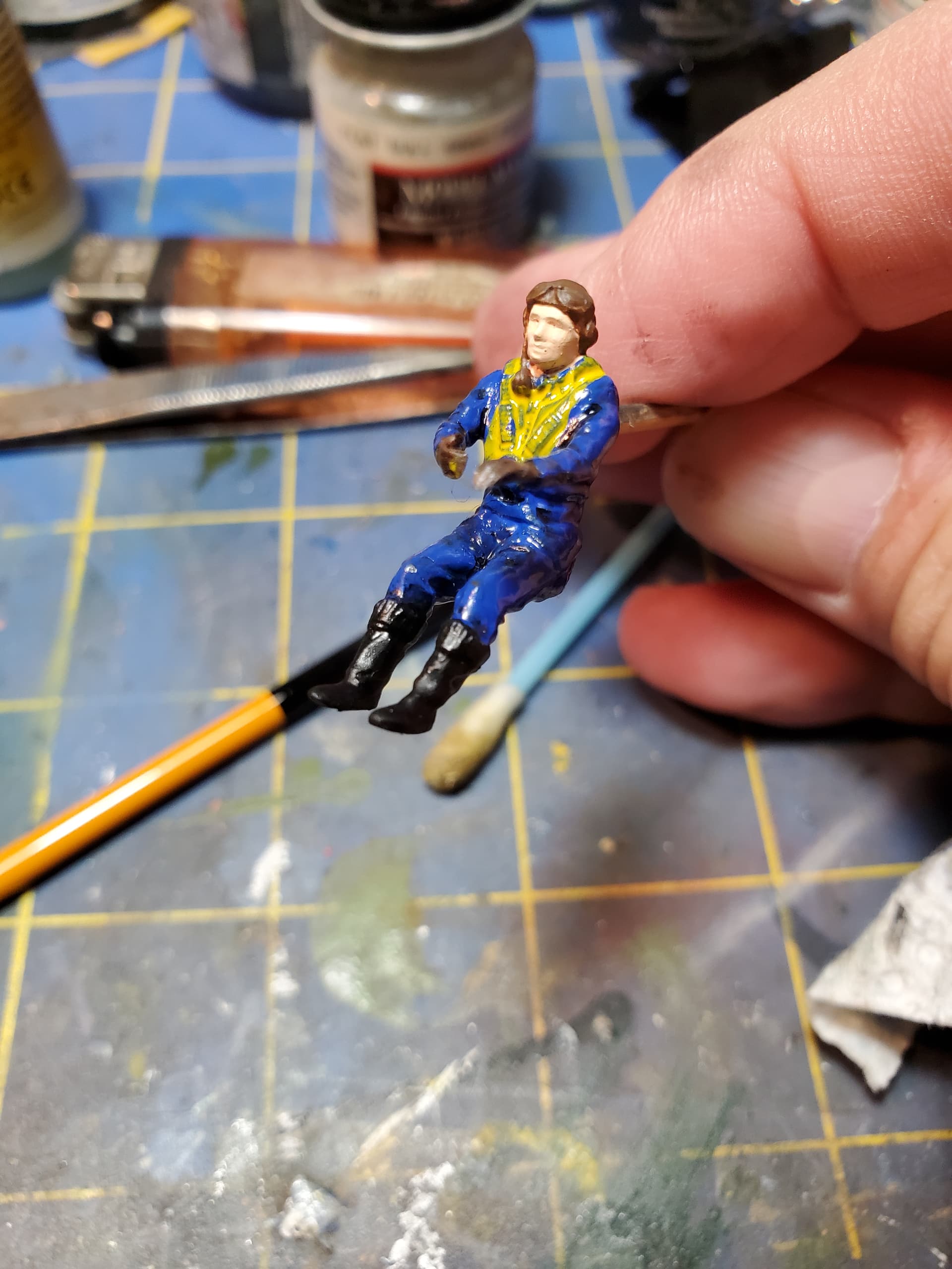

Anyway i got the pit almost done and i plan to make it in flight so i grabbed a pilot out of an airfix spit kit, took a best guess at the color. i am not done with him yet, still need to shade the highlights, another coat of yellow on the life vest and a wash for the face and an overall dull coat.
and the dash using the kit supplied decal and walthers solvaset. used dabs of mr color super clear for the gauge lenses. came out pretty good i think.
Joe
Nice work Johnny its look good.
Hey Joe looking good. The pilot looks good to me. The spitfire looks so much cooler with its legs up. Look forward to the end result.
Pete
