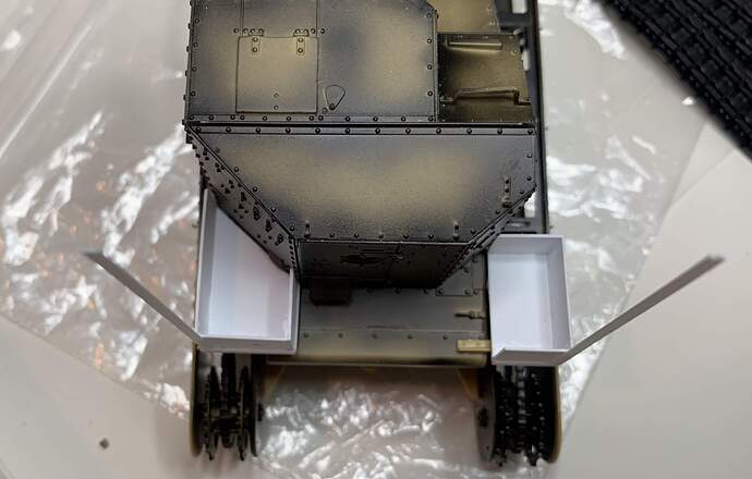

More work on the Whippet storage boxes. I have seen some rectangular box missing the inside side. Seemed interesting to replicate.
Base coats down now. Now need to add wood effects, cut masks for roundels and add a few decals.

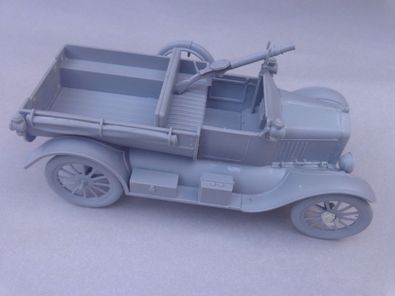

Some advaces with this nice kit. Really an easy build.
Next step: figures
That Model T really looks like a Model T. I’ve got two of them in my garage to compare. It is hard to get the shapes right but ICM looks to have got them pretty close.

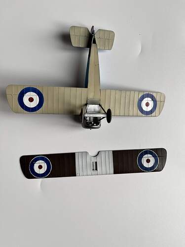

Finished detailing the Camel.
Cut masks using the Cricut having measured the decals to ensure sizing and proportions correct. I tried photographing the masks but they don’t show up well. However essentially applied the main mask first without central layers and then laying down the white.
I then added the inner mask representing the blue part of the roundel (also the outermost thin mask for the white on the upper wing roundels). This allowed me to position the masks correctly for the inner white and central red parts. I then removed the outer part and laid down the blue. Lastly I removed the central mask and laid down the red.
Not perfect on the outer white section of the upper wing roundels as that section of the masks were very thin and difficult to position, however overall happy with the result. The tail fin flash was much easier, simply using thin strips of masking tape.
Lastly I added a few of this particular aircraft’s marking specific decals from the kit. @phil2015 let me know if you want the rest of the decals including the roundels for yours.
Also pretty pleased with the wood effect on the front end of the fuselage behind the engine cowling, the wing struts and the propeller.
Looks Awesome Digger.
Wow, that looks really great. My wife doesn’t have a cricut, but she has the competitor’s model. I guess I need to figure out how to use it…
Thanks both. Best gift I ever bought her! fairly simple to use and capable of some fine detailed cutting.
