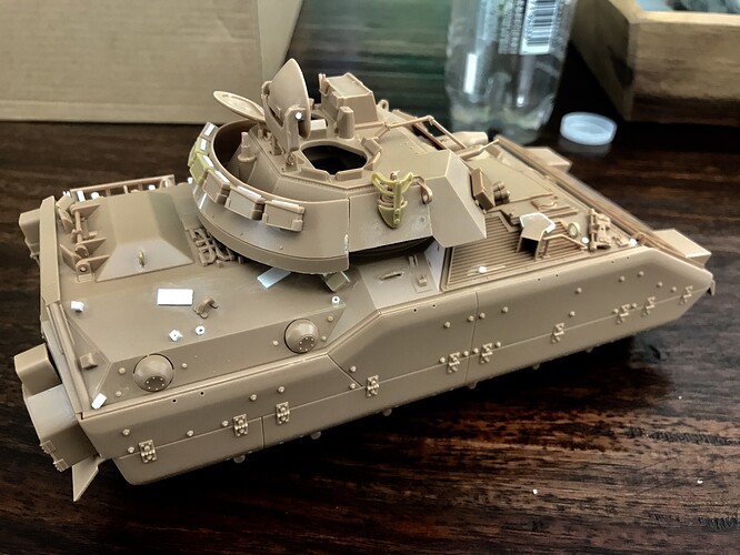

A little more progress today. Working on small details on upper hulls and three interiors, using the footman loops. Also, Jacque’s fire suppression system unit intended for the M2A2 works brilliantly on the OG M2. It should become a standard component of any Bradley build. I"ll be adding one to every Bradley that I can. The shape is superior to the Meng unit and the sheet metal housing is much closer to scale thickness.
The floor on one of the interiors. Note use of footman loops again. This is probab;y the most versatile accessory to come along in quite some time.

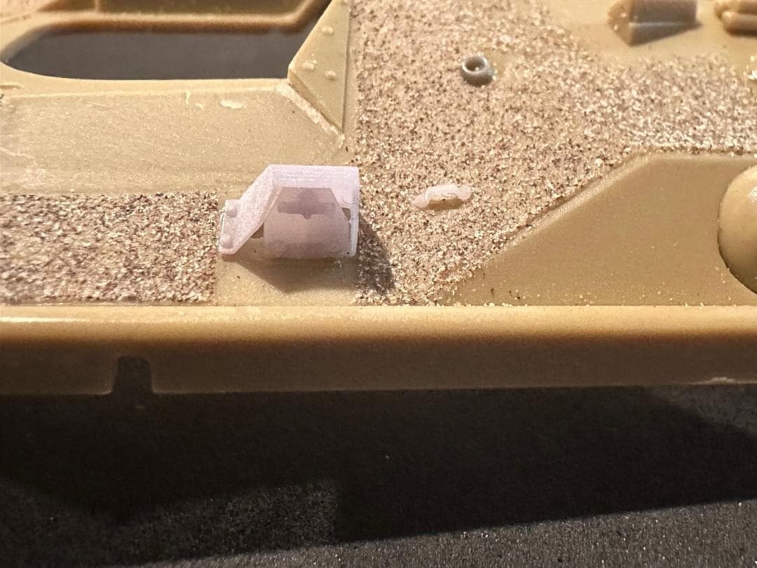

Those swim barrier brackets ( I believe that’s what they are) would be a perfect candidate for 3D printing.
They would. That’s why I’ve been putting them off. As Jacques has liked your comment maybe there’s hope!
Maybe a bump stop for the loader’s hatch too.

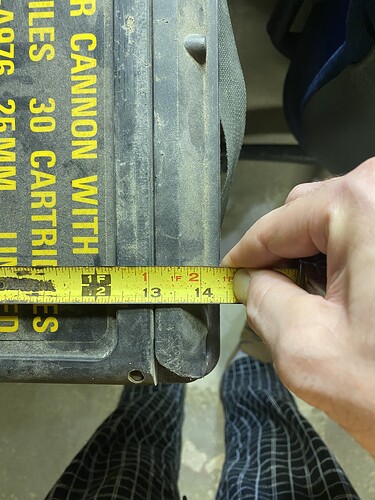

I only have the dimensions of the metal ones, but in side by side photos they look at be the same as the plastic. Both hold thirty rounds. As I said in another thread, the Djiti boxes, both metal and plastic, are just plain wrong. Noticeably so.

Plastic ones are 5.66 x 13.375 x 14.375

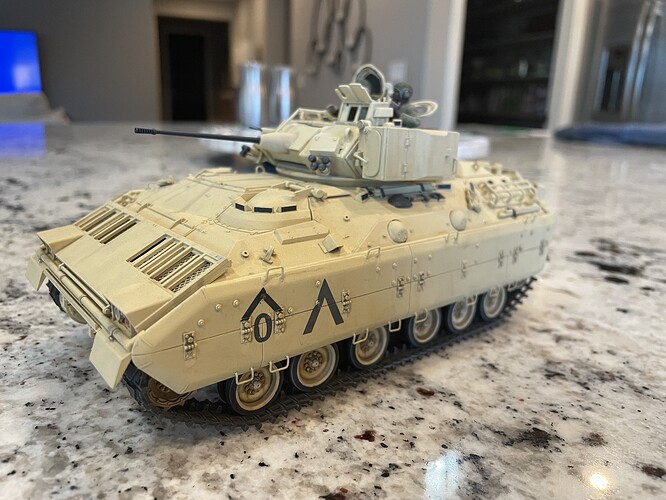

I’m really not quite done with this, gonna eventually add stowage. I have also repaired and repainted the damage to the bustle rack. I also repainted the crew and added antennas.

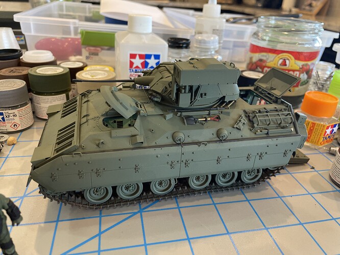

One more, this was built decades ago and repainted this summer, this is pre decal and weathering. Some of the scratch detail is a tad off. I’ll get a couple pics of it with decals later this week.
Fantastic work. You caught the incorrect stowage bin as well. But your in progress photos don’t show the welds you put on the corners of the side skirts. Other than myself, I’ve not seen anyone else do that. Little details like that really set your build off. Legend wheels?
I’d have to look, but that’s pretty close to the metal ones. I do remember the metal ones are .75 inch higher than the are long, so the dimensions cannot be exactly the same as the difference in the plastic boxes’ height and length is one inch, Either way, very close. Thanks for posting.
