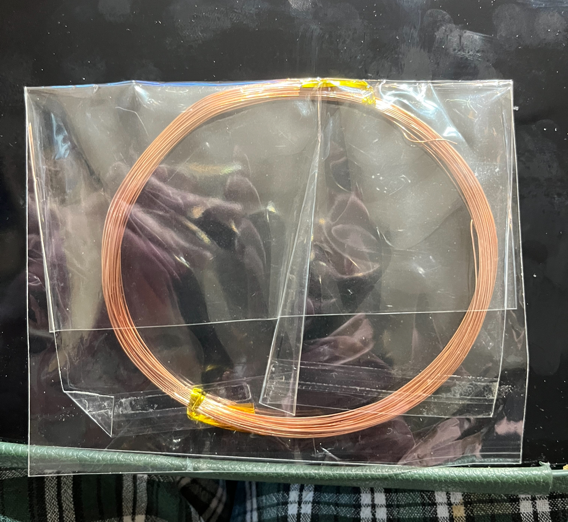

Some copper wire to make up connectors for my M813 TPU’s two pods.
Other uses will follow……….
