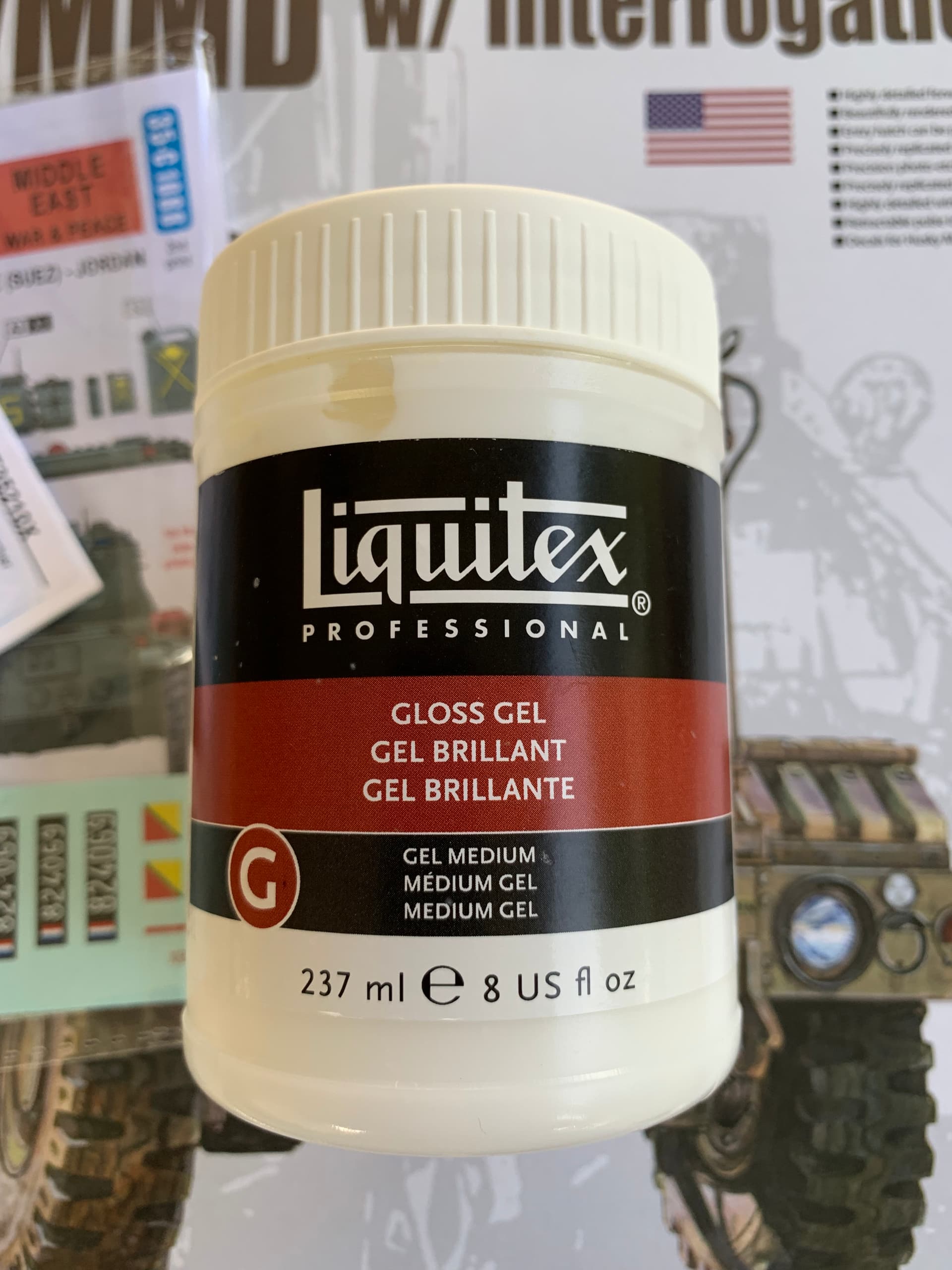

This is the correct product @SdAufKla to substitute for Gator Glue?
That stuff works absolute wonders for PE parts. I use it almost exclusively in place of super glue. It’s got a very strong bond once fully dry, remains somewhat flexible so little bumps won’t cause PE to fly off into another dimension, and best of all without being sandwiched between two parts it doesn’t adhere that well so once dry you can clean up and messes with a flick of a number 11 and some very light sanding.
@SdAufKla directed me towards it and I have had a much friendlier time with PE since. It’s also nice in that if you wet a brush dip it in the medium and then touch it to the side of the PE part it has some decent capillary action, often I’ll fix a PE part with a small dab of the medium and then once dry I’ll strengthen the joint with a little touch using the capillary action

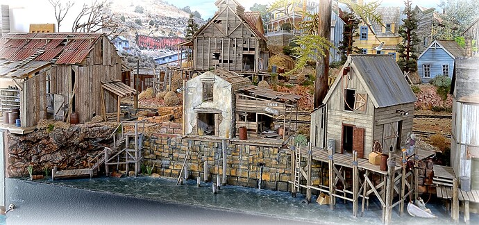

Caution with the Liquitex gel. I’ve used it for years. DON’T let it get wet. It will soften and maybe let go. I used it for water scenes. After a while the dust collected so to clean it up I use a damp/wet cloth. It softened the surface and went tacky. Here where we have almost 100% humidity it can take forever to cure.
For PE I use craft tacky glue. ie thick pva.
bruce
Indeed, that’s the stuff.
Basically just a gel acrylic medium without any sort of texturing or aggregate material. Just about every brand of artist materials has a similar product in their lineup - Grumbacher, Golden, Valljeo (in their artist acrylic paints line), and, although I’ve never seen it, I suspect that W&N also sells something similar.
All thin and clean up with ordinary water. The strongest bond results after drying overnight. Once dry, just like with acrylic paint, the glue bond is waterproof (unlike PVA - white glue - which can be redissolved with plane water).
The liquid acrylic mediums also work quite well as light duty adhesives with the same waterproof bond. I use liquid acrylic matt medium all the time as an adhesive as well as a component in a homemade acrylic paint thinner for brush painting Vallejo, Citadel/Games Workshop, Reaper, etc.
For thick applications to create clear textures (like water surfaces), once the gel medium has dried out, it can be over-coated with a clear acrylic like Future floor wax to harden the surface.
“Thick” is a relative description, though, and I’ve found that it’s best in multiple coats to build up the textures gradually. It’s not suitable for thick “deep” applications. Not only does it take a very long time to dry, but it also shrinks quite a lot.

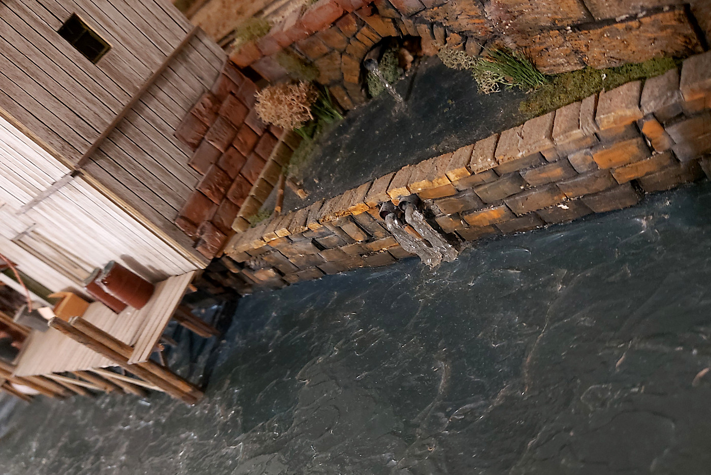

SdAufKla I’ve used the Liqitex gel for a harbour scene on a railroad layout. Applied in one shot at about 1/8" thick. It goes on white and becomes clear over a few days. But put anything wet on it and will soften. I’ve had no issues with shrinkage.
It’s great stuff but I would use with caution.
bruce
So the Gel is a substitute adhesive for PE parts?
I can be used for that. Also works well for clear parts - canopies, windshields, light lenses, etc.
It does have to dry completely, though, to reach full strength. My experience is overnight is necessary, really. It will appear dry and reach a clear state in only an hour or so, and this can be misleading. At that stage, it will still be very soft and flexible.
Once completely dry, it has excellent shock resistant qualities and good shear and tension strength. It’s not the absolute strongest glue, nor is it the fastest curing. The total strength of the bond is a factor of the cross section of the glue mass and the area of adhesion.
In very small cross sections, it may not have the strength needed, so it may not be suitable for edge joints or assembling large PE subassemblies.
It’s real advantages show with PE to plastic bonds where it resists the infamous “popping off PE parts” problem. It will usually flex and then return to its dried state whereas PE glued on with CA often just flies away when bumped hard enough to break the glue bond.
The gel should be on all modellers work bench. I said I prefer tacky glue for PE parts but that’s my choice. If you want a diorama with water the gel is magic. I doubt it would ever go hard. More like a strong rubber consistency over time.
The below image is the gel about 1/8" thick over a painted ply base. The water coming out the pipes is the gel brushed over a fine piece of wire. This scene is about 4 years old and I can still push my fingernail into it. You can push and pull it for a few hours before it starts to solidify. This surface took about 48 hours to become fully clear. But we live in a sub tropical climate so the time will vary.
