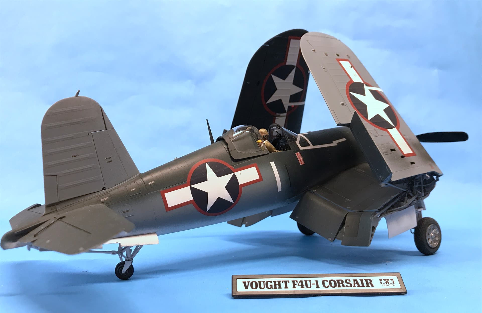

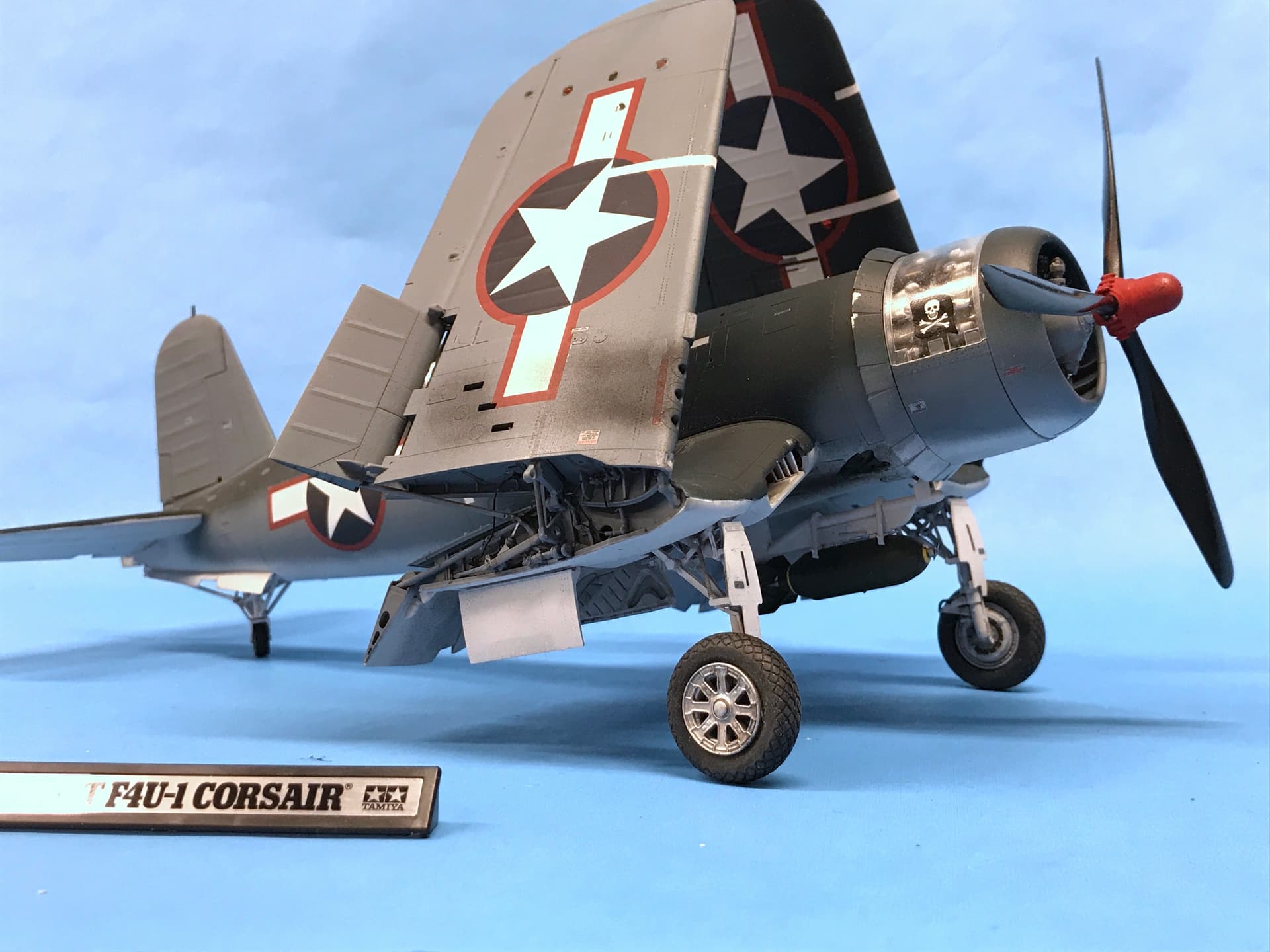

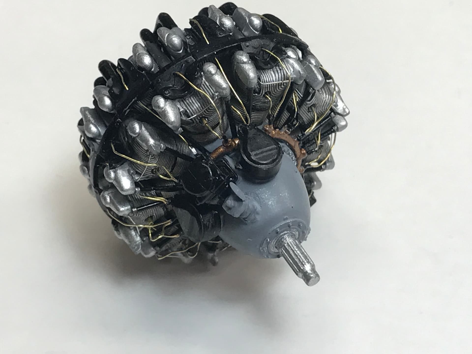

Why suffer? The Tamiya kit (if it’s the 1:32 scale) is a technial marvel that fits together beautifully and builds a magnificent model. Practicing on a poor kit, can do as much to be a dis-incentive as build skills. Out of the box, the Tamiya kit is great. You can also do some serious super-detailing and get a show-stopper.
The Tamiya model needed zero filler.

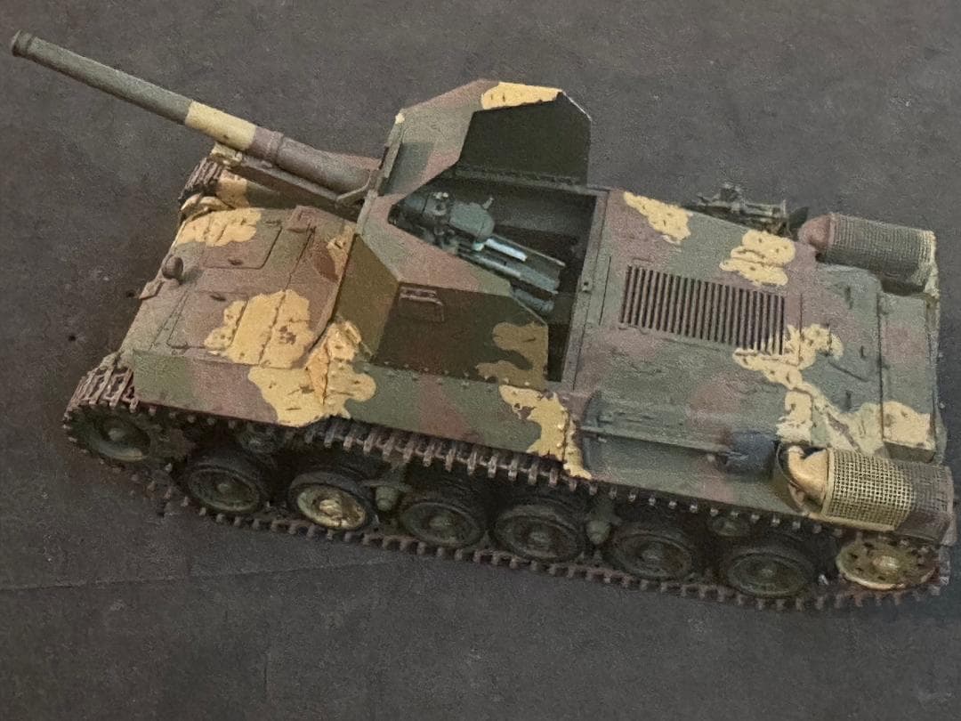

For armor, I recommend the Tamiya Japanese Type 97 tank. Goes together nicely with no real problems.
I would say start with the cheap one. Get your “juices flowing”… Once you feel confident enough to tackle the more expensive kit, you’ll be ready.
In one of my more Captain Obvious statements, I’ll say this: That depends on you.
Yes, that kit goes together very well, but like the SPG that’s based on it, are you going to be happy in the end? While not bad looking, the exhaust grills end up looking toylike, and the rubber band tracks are some up the worst - especially if you want to induce realistic sag into them.
Or, it can be an opportunity to up your game, use the PE as I did, and run some brass rods throught the hull to tame the tracks. I could not on the SPG version due the open compartment - it would’ve looked odd with a brass rod running across it, but I did manage to get the track to settle down on the return rollers, which it doesn’t want to do.
The other plus is it’s less than $20 on Amazon Prime.
My Corsair is the Tamiya 1:48 scale version. I will probably start it this weekend! I will have to do some research, I am not sure a 1:32 would fit into my Amazon special spray booth! it is only 15.25" wide, 14" deep and does a good job! The Engine detail looks amazing in the pic! Great Job! I would like to see you do a Hawker Tempest with that crazy Sabre Engine!

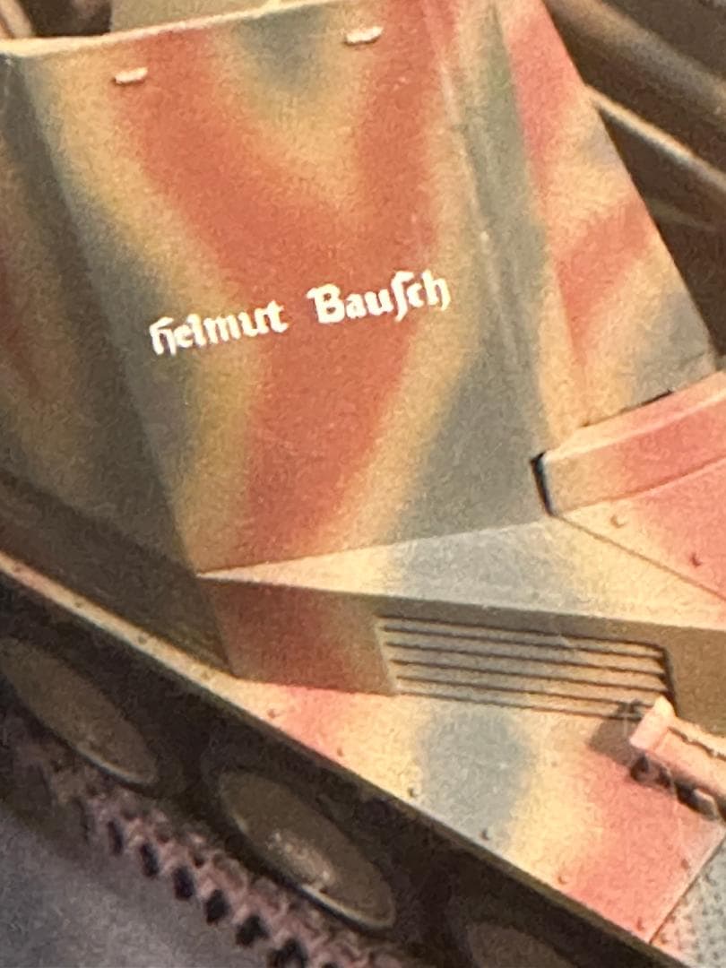

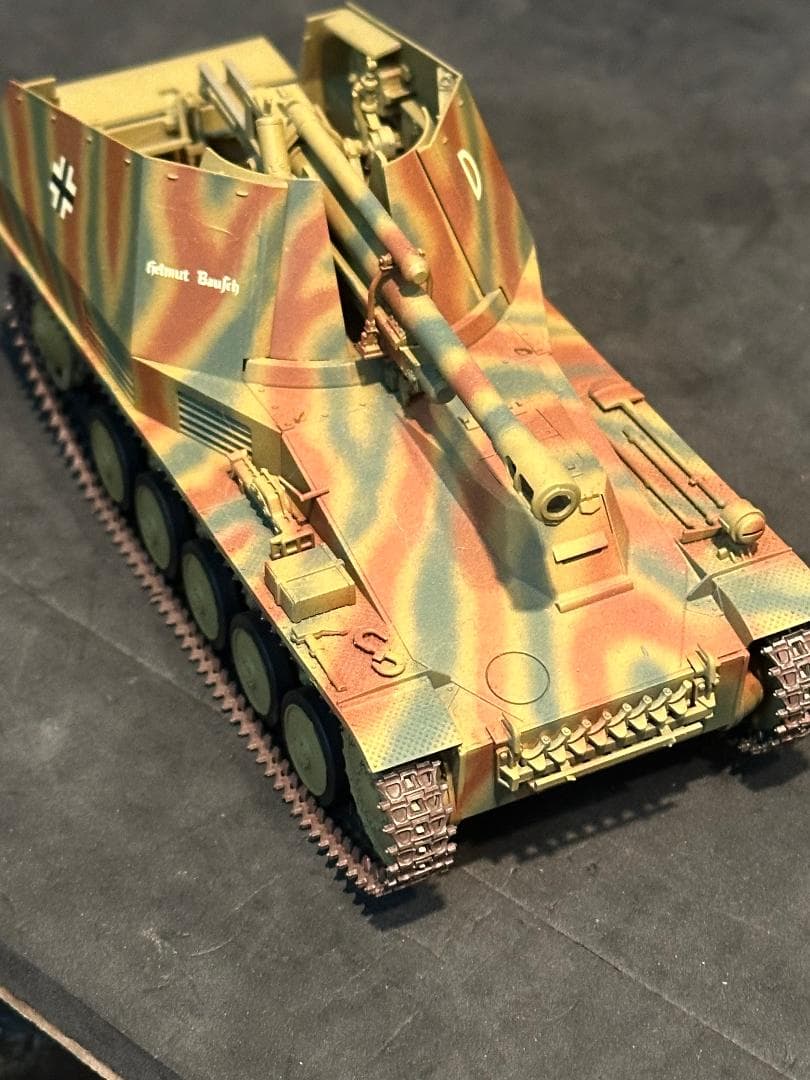

Almost all Japanese WWII armor was brush painted. But if you want a good airbrush workout, the Tamiya Wespe might be a good choice. Free shipping once again on Amazon Prime.
l should probably finish this one.
Not my best cammo job. But if you’re just getting back into it, the basics are more important, like decaling a model properly. Some folks will tell you the camera magnifies everything. But the camera don’t lie. Basics first, complicated stuff later.
Looks like a good choice! WW2 Germany had some great Camo Schemes! This could be a good skill builder for me.
The 1/48 kit is also a good kit. Tamiya just kicked it up a notch for the 1/32 kit. Which shouldn’t be surprising as that came out later (2013-2017) than the 1/48 version (1996-2002) depending on the version.
