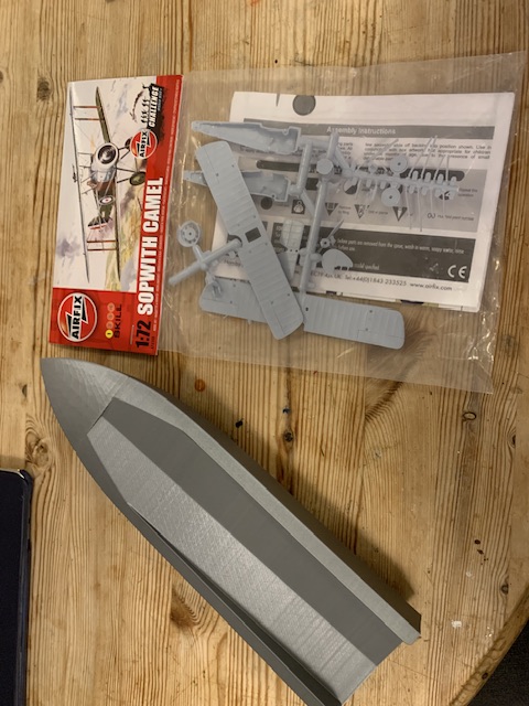

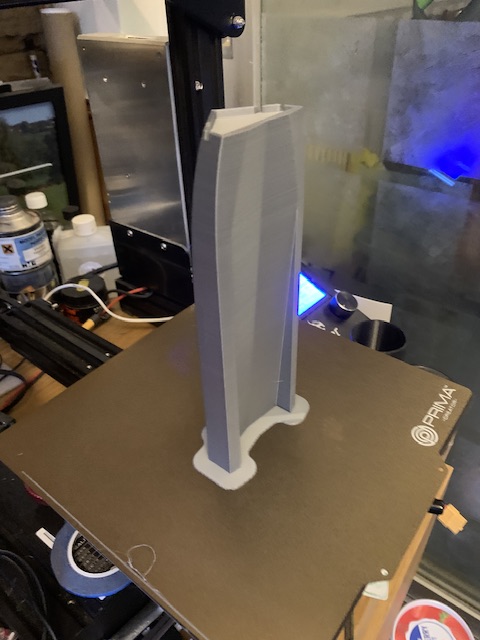

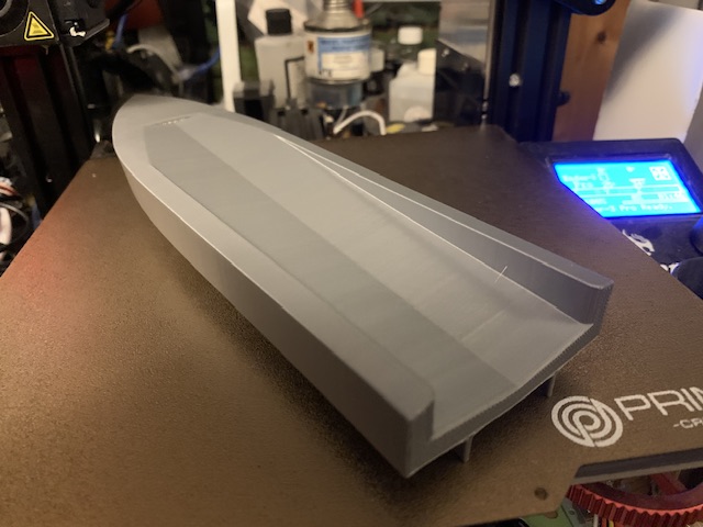

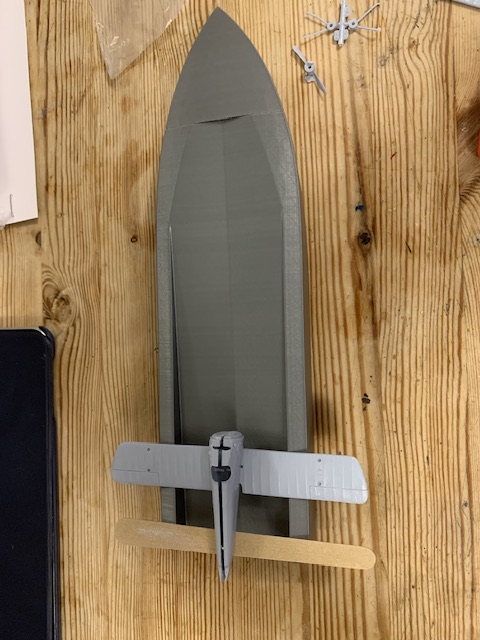

I wanted a break from Jackal and I found a builders plan online, so spent a few nights drawing a hull This as I mentioned a week or so back is a Towed Aircraft Lighter, a tiny (58ft) unpowered craft that could be towed at 30 knots behind a destroyer. These lighters could carry a Felixstowe flying boat in the well or a 2F1 Camel on a built up deck over the well. The lighter could ballast down to release or recover a flying boat but the Camel was flown off the platform and ditched next to the lighter where it could be recovered using a derrick
IMG_1149
IMG_1151
In this way Lt Stuart Culley shot down a Zeppelin L 53 on 10th August 1918 from lighter H21 towed by HMS Redoubt

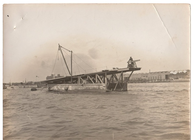

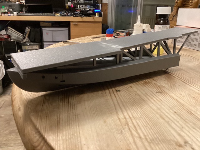

I have seen those sites, this is what the fully converted lighter looked like, I am designing the flying off deck now
IMG_6996
The Derrick must stow somehow below the deck but I can’t work out how at the moment. The downward slope was needed because the bow rose at speed, levelling the deck.
Interesting, compare the deck with the one I posted first?
The one you posted first was the first try. The aircraft was fitted with skids and that and the uphill slope made the takeoff too hazardous. The later one that I posted used the standard Camel undercarriage, the aircraft being held back by a lanyard clipped to the bomb release to stop the aircraft moving forward. To take off the pilot applied full throttle and pulled the bomb release. The aircraft was off the deck in about 5 feet with a 30knot tow speed plus wind

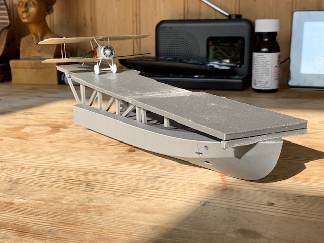

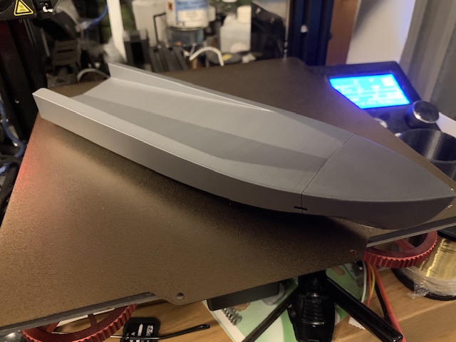

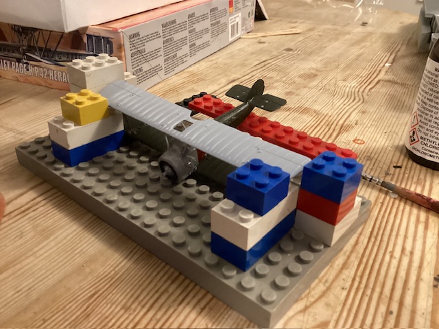

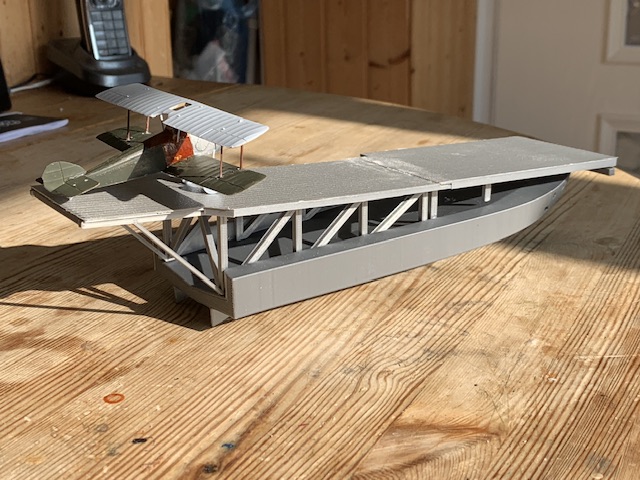

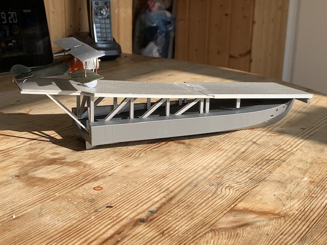

First look at the Towed Lighter and Camel together. Still quite a bit of work to do to both, including rigging the Camel. The kit is a b**tard to assemble, probably the second most difficult biplane I have done (the Roden BE2c beats it by a small margin). Not sure whether to repaint the green, the Airfix instructions show Light Olive, this is Tamiya Olive Drab. Need to print two Lewis guns, Airfix only supply one.

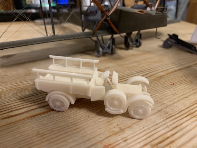

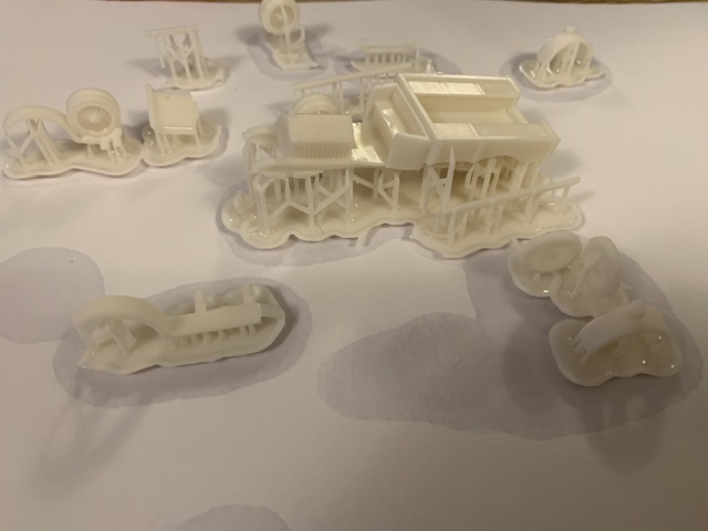

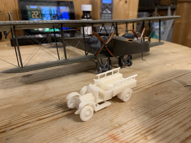

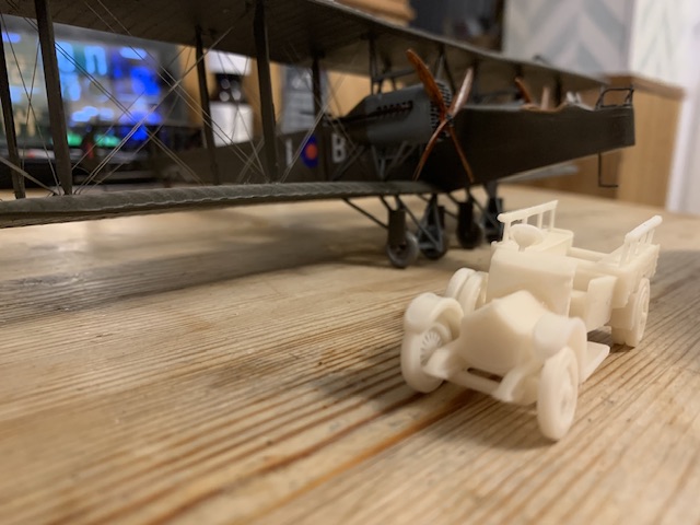

Is this the future? Ordered this Crossley Tender on line. Delivered as a set of about 20 .stl files from Trenchworx to a native scale of 1/56. I printed in two scales 1/72 and 1/48. 1/72 fits into the tank of my Creality easily, Needs 2 prints at 1/48. Assembly is simple and I think looks ok, could do with a hood but not bad. This model shown is 1/72
IMG_1169
IMG_1171
IMG_1174
IMG_1175
Now to throw some paint at it.

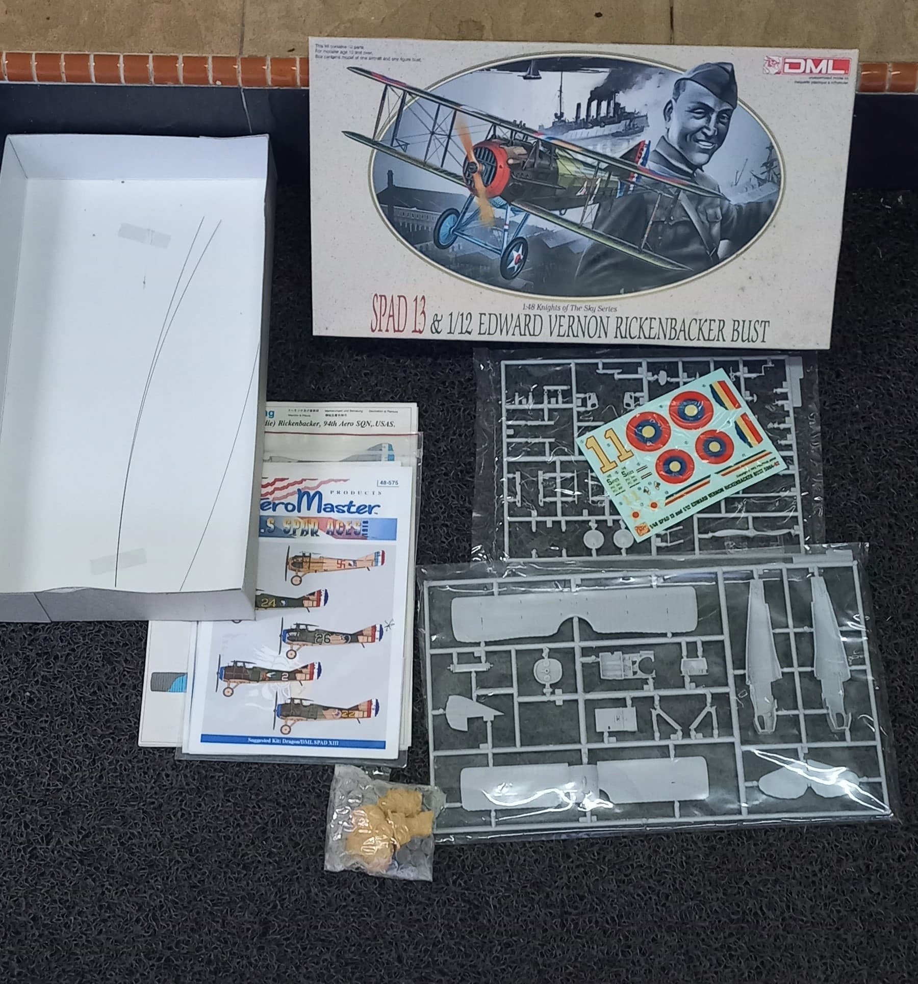

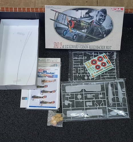

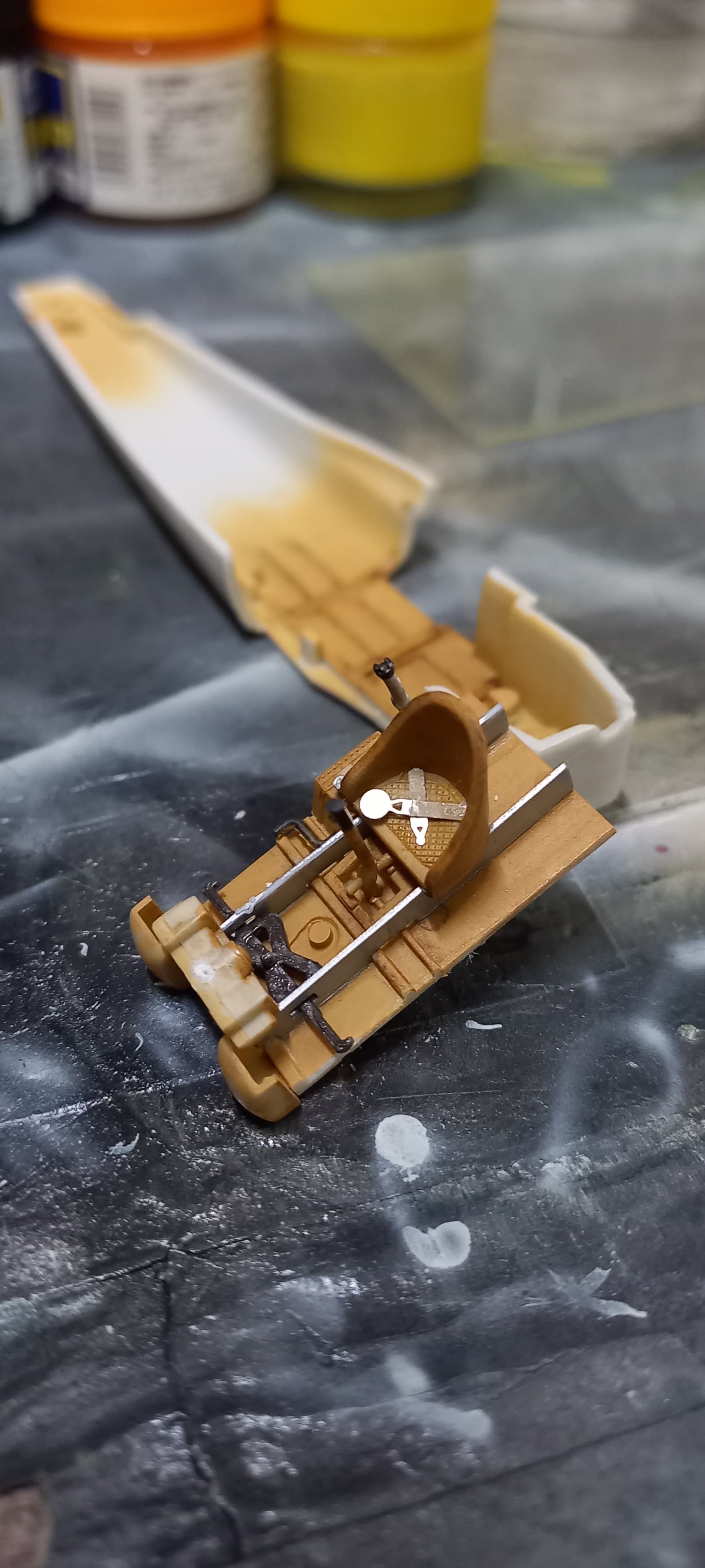

That said, I’m shifting gears and will be doing Dragon’s SPAD XIII from their “Knights of the Skies” series, circa 1992, which includes a 1/12 bust of Eddie Rickenbacker. Looks like a straight forward kit and includes PE to help with the rigging!

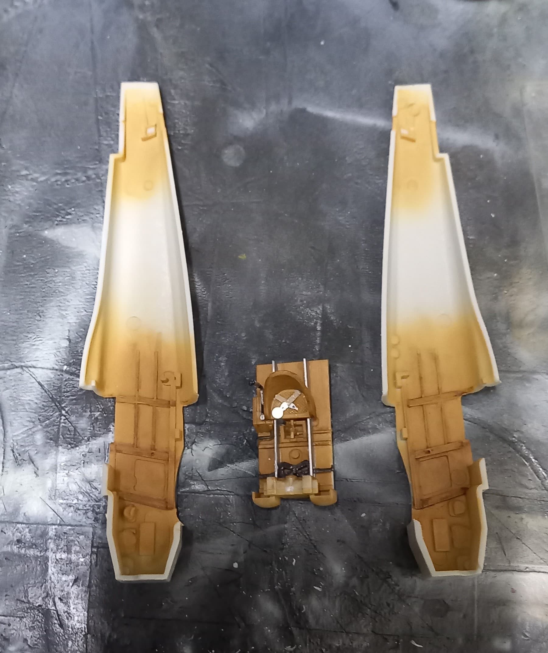

Work starts off on the interior, and I got to practice a bit more on my oil staining technique to make plastic look more like wood!
I really like how the cockpit floor and stringers turned out. The interior of the cockpit assembles nicely, however the PE that’s included is extremely thick and difficult to separate from the PE sprue(?). It’ll look alright once everything is closed up, and definitely gives the appearance of seat belts.
The fuselage will be closed soon, and then getting the airframe complete for the rigging process,. Till then, be safe and have fun!
