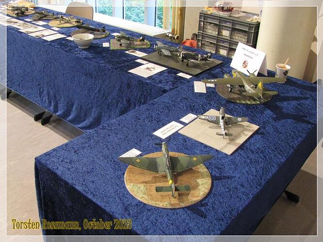

Last weekend I had another great time at the model show in Thionville. It was my last show for this year and I’ve already got some invitations for next year. First show in March 2024 is already fix. Maybe you like to have a look at my report … :slightly_smiling_face:
